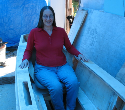

    That's freeboard. Hull depth is 10 inches more. Here's a snapshot I took when I was building, and because the coamings aren't on yet, you can get a better idea of how things are arranged. I think the coamings help a lot to keep the boat dry, because even when water makes it to the decks, it never spills inside.

    --- Wow, 36 inches depth amidships (or at the bow?), I have missed that, and the photo makes clear how big you hulls really are; I can better imagine the cabin thingie -- could you post a photo of that at some point? Anyway, this sounds great. If the packing is done well, you won't loose too much of that (I think your hulls flare almost dory style?), and I'll bet the boat will be generally comfortable. Bets off only at some of the dangerous passes and at Cape Romano Shoals in the wrong wind (neither of which I have experienced, only heard of; one of the factors in my abort decision last year was Imagining getting around the shoals in a bad wind without a rudder to help out, assuming the Caxambras Pass tide/wind would not allow cutting off the shoals). Oh, yeah, you do have some ideas about how to repair a rudder, right? I guess you have two and could sail on one if need be, but please I beg you be ready for rudder repair! :-) This haunts all multihulls in the EC -- Wade

    I've really been meaning to write a blog post on the thing, but I've been pretty busy getting ready for the EC, and other stuff.
    Anyway, the height in back was necessary to get sitting headroom. The boom does clear the cabin when the sail is hoisted. I'm going to have to remember to set up the topping lift before raising sail in blustery conditions.
    The bunk flats are sectional, so that the aft two segments can be pulled back and one forms a seat back leaning against the coamings. The forward two sections are set up so that the aft piece can be flipped up and will hold the netbook securely in the stringers that stiffen the flats. That also gives plenty of leg room, so you're sitting in an ergonomically comfortable position. The bunk is about 24 inches wide with a couple of self-inflating camp pads under the sleeper. I'm adding a cabin light and a telltale compass, so the watch below can keep an eye on the heading, just in case the watch on deck gets confused.
    It's definitely a kludge, but it only adds about 40 pounds to the payload. It's 1/4 inch stitch and glue ply, stiffened with stringers on top, and external stringers on the lower edge. That handle is to lift it off easily, and also to keep the hatch from opening too far and stressing the crappy carpentry. (The hatch corners are half-lapped, but before I added the handle, I flung it open one day and broke it.)
    We''l see how it works. The good thing is that it's easy to get rid of.
