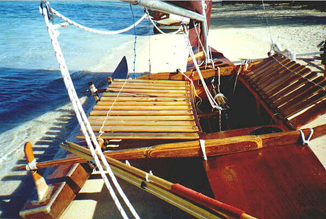

    --- That's true. I had the interesting opportunity to sail on a kind of a paraw during the 2009 Everglades Challenge. The skipper took a proa hull and put two long bamboo outriggers on it, about 6 inches diameter. Unfortunately we ran into some bad luck and had to drop out that day, and the wind was very light. In the light wind the boat stood up easily. The skipper and builder, Carlos Solanilla, had built a third aft aka and strung trampoline canvas there to form nice hiking platforms about 30 inches wide and 7 feet long on each side, as some Philipine paraws have. We each took one to balance the boat for part of the day -- comfortable! I felt like The Grand Turk lounging there. A few times in better wind I sat on another bamboo to windward (pola) not as comfortable by far :-) On shore as we were disassembing the boat, I was testing those amas while the set up was in the water. With my foot on the center of one ama, I could easily sink it right down and under. I was rather shocked how easy it was. I am still very curious about how that boat would have behaved in brik wind, how much more athletic I would have had to be to keep the lee ama up (my crew role was as the intelligent meat ballast). When I have watched videos of the Philipino paraws, there always seems to be a crewperson standing out on the WW ama. -- Wade

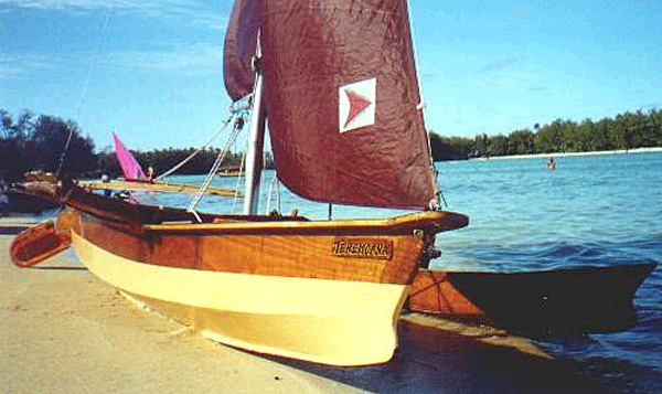

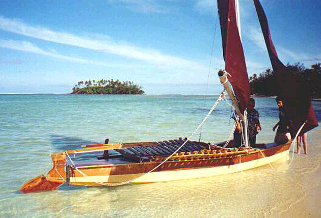

    Hello all,
    My post is a bit long, but I think it is better so you can see my thought process and can give some suggestions better...
    Build experience & usage plan of a new boat:
    I have built a plywood skiff FL12 design from Bateau.com (Jacques Merterns) using stitch & glue design. This was to get my feet wet and also to have a boat to have fun on the water while building a new one. Next one which I have decided to do was CK17, a 17' feet sharpie with a unstayed cat ketch rig. It is a boat of ample size for me and supplies to go cruising, it is trailable, can be single handed and can be beached where I can sleep in the tent on it overnight (or tent can be on the beach - whatever). Also, for cruising it can fit me and one more person easily. When I mean crusing I do not mean extended cruises but more beach hopping with only 1-2 nights that I need to carry food or water with me. I can easily sail to a nearby town and go to the store to resupply -> my location: Adriatic sea.
    However, with my experience with FL12 along with CK17, they are displacement hulls, so CK17 top theoretical speed would be sqrt(LWL) * 2.43 which is about 5.5 knots. FL12 theoretical top speed is 4.5 knots, but in my experience when I sit aft (220lbs) and my girlfriend at the bow (approx 130 lbs ) at 3.5HP at 2/3 throttle is max we obtain and I think it is hoovering around 3-3.5 knots judging by the distance and time we cover. To island hop in my area means covering about 3-5 nautical miles on average and then you can go along the shore to wherever you want to land. Therefore, I started to look at other options since FL12 is unsafe to do longer sails with, because if bad weather hits we would be in a very bad situation. With CK17 it is very much doable and we can carry lots of supplies, but it would take 40-50 mins to do the crossing while traveling at top speeds. Loaded, it means we would need good wind, which also means slapping and pounding and is at the speed/wave/weather limit of the boat of that size to sail.
    Perfect boat to fit:
    1. It should be cheap and easy to construct - I do not want to have to build a boat for years; I do not want to break the budget by using some high-tech stuff or custom machined parts where a simple rope lashing can work. I also do not care about showroom ready finish.
    2. It should have utility I need - safe and fast island hopping, beachable, single handed ability. Light so it is transportable by a car and launched from the beach (saves my costs!)
    3. It should be "fast".
    4. It should be of plywood construction and epoxy/fiberglass. Exotic wood is not easy to find here and is not cheap. I can more easily laminate iako for example from plywood and epoxy than to buy some exotic hardwood and shape it. Okume marine plywood is available; I have used it with FL12 and it works nice; did boiling tests; one piece of plywood is out on the weather now for 3rd year and looks like new....except its grayish.
    5. It should be durable - I do not want to build another one and then another one and so on. So if I need to spend $100 more on a proper paint but will add to years of trouble free usage - so be it. Same with masts, etc.
    Multihulls:
    So I started to look at multi hulls. As I know of Wharram, I looked at this designs but opted out since there are budget constraints. I do like TIKI21 though or TIKI26. Hitia 17 is OK, but sits too low on the water. I am perfectly fine with an outrigger / proa for my budget and usage plan. No need for 2 hulls, so:
    I came across Gary Dierking designs;
    2 designs that would fit my bill are:
    Waapu and Tamanu.
    20-24 feet is an OK size to manage by myself and my building space is perfect for that size. Also bill of material is not that high so budget is met. Hulls seem easy and fast to construct. Their design speed is for 12 knots, which means I can reach my destination much much quicker than with CK17. Also in case there is no wind, it is easier and more efficient to paddle.
    I wouldn't mind getting rid of the hardwood chines and use fillet + fiberglass tape instead; no need to buy hardwood; no need to be precise about joints. What do you guys think?
    Waapu:
    Benefit of Waapu that I see is that it is a 3-piece hull for 24 feet. I can transport it in pieces in my car and avoid the eyes of port attendant to lanuch from the beach at some more remote spot and not pay the fee. No need to buy the trailer or have to sweat by backing the trailer with my car LOL
    I am not sure if 4 8mm stainless steel bolts are OK to keep all 3 pieces together in all weather conditions I may get into. 8mm ss is strong a lot, but....I think that connection would be a weak point vs. one-piece hull. Also, it doesn't have decking so I don't have dry compartments for my gear.
    Tamanu:
    Tamanu to me looks a bit better; has self bailing cockpits; dry storages; Only drawback is that I would have to use a trailer; Also I am not sure about light version of 4mm sides vs 6mm sides. Okume 4mm is about 13 lbs for a standard plywood sheet and 6mm is 20mm. So plywood weight difference would be about 32 lbs. But would I loose durability with 4mm sides? In any case I plan to put a 6 oz fiberglass fabric on the outside including bottom.
    If I build Tamanu, I would like to do all the fittings on main hull to convert it for a double outrigger later on; but first I guess I would do the single outrigger
    I can't see on the website what is the maximum load of either of the design? So I know how much weight (crew + gear) is allowed on them.
    Things to think....
    Also, it seems to me that Tamanu is a newer design which maybe that perhaps construction method was streamlined due to experience compared with older designs and that perhaps some things that were show to "work" were incorporated into it.
    I also wonder is it possible to add shunting rig later on on Tamanu to experiment with.
    So what do you guys think? And of course if you have some experience with seaworthiness, maximum loads and performances say wind speed vs. boat speed that would be nice.

    Both would be great for your uses. I built a pair of Tamanu hulls with 4mm sides (plenty strong--even 24' tri's use 4mm). They still are about 100 pounds which make it a challenge to cartop unless you have two strong guys and a beefy roof rack. However it's already put together making it the faster boat to launch. Unless you have a big van or something similar, it'll be tough to put all the pieces in a car though.
    If you have the space, you could build a 24' Wa'apa with decking & think extended Tamanu. They work well as single outriggers and tris (or in my case cats). Trailering them makes more sense to me though.

    Wade, really interesting about that Paraw. I am curious as to how it stays right side up with so little buoyancy in that bamboo float? Is it like sailing a canoe, but with a slightly greater margin of safety? Does the vaka have some beam to it that aids in stability? Just seems like you gotta have some cojones to sail on one of those, especially with all the canvass and headsails they fly!

    ...Wade, really interesting about that Paraw. I am curious as to how it stays right side up with so little buoyancy in that bamboo float? Is it like sailing a canoe, but with a slightly greater margin of safety? Does the vaka have some beam to it that aids in stability? Just seems like you gotta have some cojones to sail on one of those, especially with all the canvass and headsails they fly!...
    --- First, we sailed in light conditions, so I too have these questions. But the natives make them work, They may also use bamboo of greater diameter or a species that is lighter (bamboo species come in a variety of 'solidness'). Second -- we were careful wityh crew weight placement. And third, the long akas (Carlos made a beautiful curved set) make good mechanical leverage use what little buoyancy there is in the amas, so that say 40 pounds of buoyant force becomes 280 foot-pounds at the hull rotation center. More than this, I can't say! -- Wade

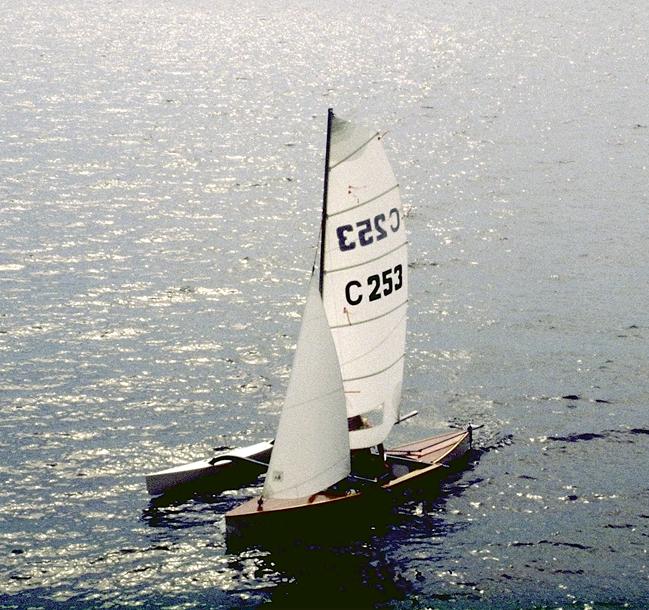

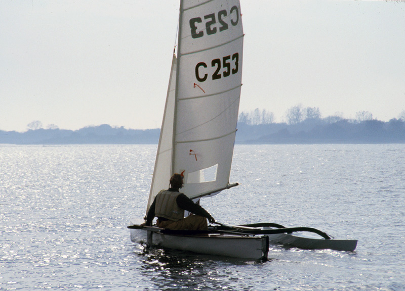

    Hi folks,

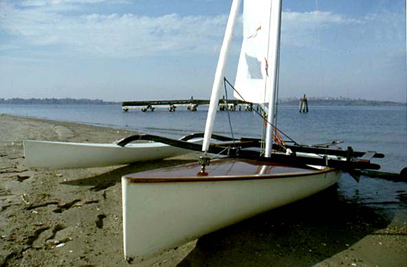

    I'm glad to see this thread has finally caught on! <insert smiley face icon here>. There is a lot of very cool boat building going on here, and I thought I would contribute some outrigger stuff of my own. I was doing a lot of canoe sailing back in the nineties, and got quite interested in the whole outrigger-proa thing after talking with Mark Balogh, who sailed with Russell Brown on Jzero upon a time (WB 83, with the Russ Brown article was on top of the stack at the time, too). I already had a great C Class sailing canoe, and it was easy to build and fit an outrigger to it.
    I used the Gougeon tortured ply method to build the ama, designing the hull around a scale model that I glued up as per their data. The model, from 1/32" aircraft birch worked well, and taught me a lot about the method. The real hull was built from 1/8" occume, with 1/4" ply bulkheads, fir sheer clamps, and fir aka socket blocking. I built the akas as hollow box beams, with laminated ply flanges 1/2" thick, and 1/4" ply shear webs. There was solid blocking in the ends, and where the akas crossed the canoe hull. The akas fit into a socket built into the ama hull. I originally used bolts and straps to connect the akas to the canoe, but switched to all lashings later on.
    I took my existing C Class sail, and added a furling jib which I also already had. Total sail area was about 70 feet. I was forced to beef up my leeboard pivot tube, from an .065 wall to a .125 wall stainless tube after putting a 90 deg. bend in the thing. Luckily home was downwind that day. My leeboard pivot arrangement works extremely well. I had used the bolt and bracket style previously, and was always annoyed with its habit of loosening or tightening depending on which side the board was carried. Fellow canoe sailor Gus Schultheiss came up with this tube arrangement (he later went on to design another pivot point at the leeboard end which allowed adjustment of angle of attack). The tube is fixed rigidly to the leeboard, and the whole business pivots inside a pair of pillow blocks, one on each side of the boat. The tension, once set, never has to be adjusted. Works great, and the tube doubles as a track for the mainsheet traveler car.
    I read a comment earlier in the thread that a canoe hulled outrigger would be slow, but it was not the case with this boat at all. She was faster with the float downwind, because (I'm speculating here) the bearing on the float lifted the canoe hull somewhat, and you could drive her harder, but it was great fun to fly the float upwind, sitting out on the seat. I took the boat down to Cedar Is. N.C. and sailed in company with Windrider tris. Nobody sailed away from me. I suffered a little from lee helm problems. The ama should have been 14 or 15 feet long, instead of the 12' I built, and with the ama bow further forward. The ama had plenty of displacement, about 200# if I remember my calculations correctly. It was just too short.
    I moved on to other boats, larger multis, etc. but I'm back building small traditional boats (couldn't afford the big one). I never finished the outrigger thing, not by a long shot, and I'm tempted to take up with the design where I left off. All the talk has me antsy!
    Jim L.

    Hi Jim! You wouldn't have the plans or drawings for that tortured ply ama would you? I am thinking about building one, same design but maybe stretch it to 18 feet...

    I do Peter. It would be easy to stretch it out, but you might want to add to the height of the sheer for a hull of that length. I have construction photos which need to be uploaded to my website, and I'll put some up here if there is any interest. I may be able to create a .pdf of the drawings.
    Jim

    Quote Originally Posted by jim_cricket View Post
    Jim
    Looks good Jim! I am messing with a bit double Tamanu project right now, but I was also inspired by the duckworks article today. I emailed Wade a list of things I think I'd want in a small tri like Mark G's. Lots of cool things to glean from all the small tri development going on right now.
    I admire your commitment to keeping things light on your canoe!

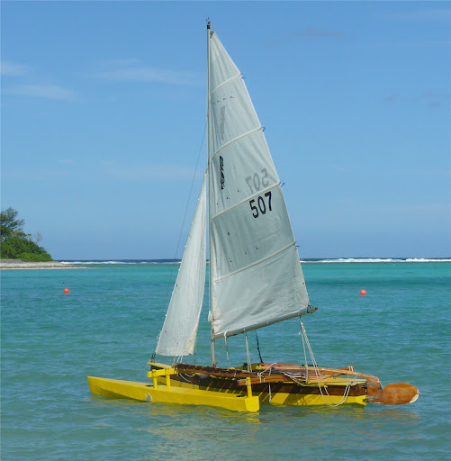

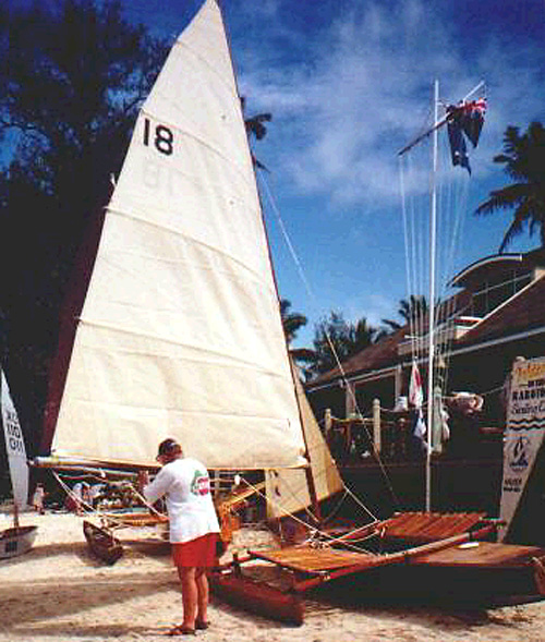

    Default Re: The outrigger and proa thread (tangaroa outrigger)
    I've had these photos on my computer for a few years, and have never found out much about this boat, except that it is a class of outrigger on Raratonga.
    Does anyone have any info on this boat? Sail area, etc. Derivation. They look like plywood renditions of an historical type. I like the vaka hull. What is the function of the bow/forefoot extension? I looked through Canoes of Oceania and didn't find anything quite like this. Looks like a nice boat.
    I've always been curious.
    Jim L.
    Jim L.
    Those look like some photos I took almost 10 years ago, when I was able to crew in one of their races. There were four or more built of the 18' Tangaroa class and they still race at the sailing club in Rarotonga. Most were built by Thomas Koteka. He has a Facebook page so you may be able to get more info from him:
    http://www.facebook.com/people/Thoma...eka/1160704706

    Quote Originally Posted by Gary Dierking View Post
    Wow, I thought you might know something, but never would have realized these were your photos. I have no idea where I got them from! I'll check out Thomas' facebook page. Thanks very much Gary.
    Jim L
    I posted a photo of one on JimD's Outriggers for Kayak thread:
    I was in Raro last March and one of my travelling companions told me that the rig used was from the Idle-Along class of New Zealand dinghy. The picture below seems to back that up, but I can't remember how he found out. I suspect he was chatting to the sailors while I was snorkelling with the kids. I more pictures of those Rarotongan outriggers somewhere, if any one is interested.
