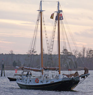

    The simplicity of a scow schooner would have been very much in keeping with the low budget nature of the effort that God failed to provide sufficient guidance for. One of the nicest things to do on a large sailing vessel is go right up into the bows where power and energy of a sailing vessel are most apparent and the square bow would provide great wheelchair access. These craft were surprisingly fast and were wide by nature which would make for great deck space in a given length. The Coast Guard passenger rules for coastal vessels are highly biased towards wide, shallow craft so certification would be feasible.
    Given a free hand with such a design, I would build the bottom and centerboard trunk of heavy steel construction so that the difficult to access portions of the vessel would be strong and long lasting. Ballast would be needed in the bottom and no shaping would be required so only cost and welding considerations would restrict the steel thickness. This is also one structure where ferro-cement might be appropriate.
    From about the waterline up, construction would be timber, very much as it would have been done in the 1800’s. Scow schooners often had large deckhouses since they were not craft built with much consideration for grace although many had clipper bow stem heads. Such a deckhouse would make roll in ADA compliant heads easy to include. Add a classic two masted schooner rig with the right paint and detailing and you would have a wonderful evocation of a forgotten part of New England maritime history that surprise some of the other schooners as it sailed past them.

    Somewhere I saw some plans for those San Francisco scow schooners. They can take a load and didn't heel too much.
    Here's some 'plans'... http://www.boatdesign.net/forums/boa...scow-5131.html

    I've been sailing on the Alma on SF Bay, and slept aboard her several times on the Delta, and I'll agree that a similar design would be perfect for DE passengers. One huge advantage is minimal heeling under sail, as that would probably be an issue in most usage scenarios.
    The alternative would be a large scow-hulled trimaran, as heeling would be even more reduced -- if heel angle proves to be a deal-breaker.
    Either way you'd probably have to go for a ramped bathroom, either in a large deck house or below decks. I really know nothing about operating wheelchairs under motion conditions, but I'm sure that studies have been done on this issue. Possibly some sort of locking motorized stairway-railing system, like those sold for older folks to ride up stairways???

    how handily does one of those scows sail
    gotta admit the one pictured is a nice looking boat

    Well, the Alma's not gonna win any races against narrower boats of the period, and won't point very high. But she's near perfect for those 30-knot days on SF Bay...

    The Alma is beautifully built.
    A most important aspect of that design is to take the ground with a full load, (like fifty or sixty tons?) and the framing is a joy to see.
    Today she is significantly underrigged compared to the original layout. I suspect she would leave many behind if rigged as original, with up to maybe 40% more sail area... The park service will have none of that though.
    I don't think Gaslight , built of steel as a yacht , is near as strong
    edit to add: The park service prides itself on taking disabled passengers on Alma. I have witnessed some interesting embark and disembark procedures.

    I always thought the scow schooner "Nina" was a lovely design. I'd like to have one as a support platform/sleeping dormitory for a whole flock of sail & oar boats.

    I 'm glad I made a special point to see the Alma when I was once in San Francisco on business some years ago. I had long been interested in Scow Schooners and really wanted to see one for real.
    Your idea that a scow schooner's deck plan and usual low angle of heel would be well suited for wheelchair mobility makes huge sense to me.
    The idea of a thick steel bottom providing a combination of ballast, high structural strength, fabrication simplicity, and low maintenance was once endorsed by Peter Duff (builder of my Shearwater yawl) in a conversation in which I made such a suggestion concerning a "dream boat" many years ago.
