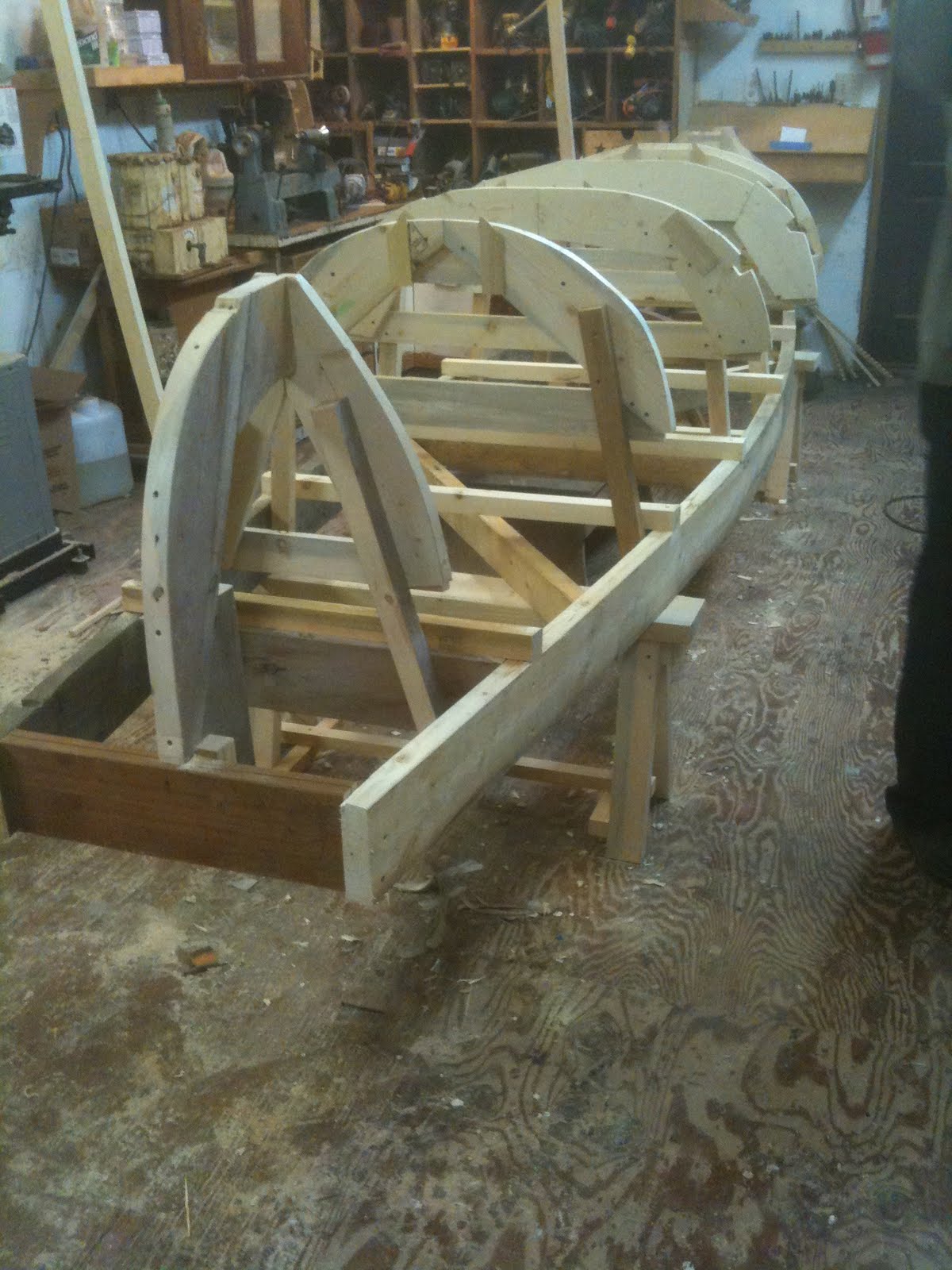

    One of the participants brought this boat for display and he left it behind after the show for a while. After walking by it a couple of hundred times we decided to build a new one using the old boat as a pattern. The original boat is too far gone to be restored but still has it's shape. We brought the boat into the shop and made molds of the inside of the boat. Then took as many patterns as possible.
    We were having a slow period at the shop so we decided to build this lovely little boat.

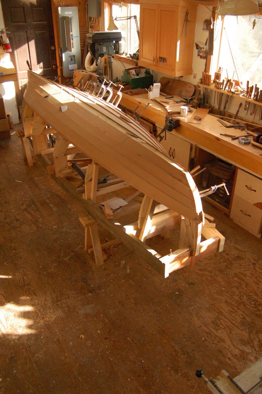

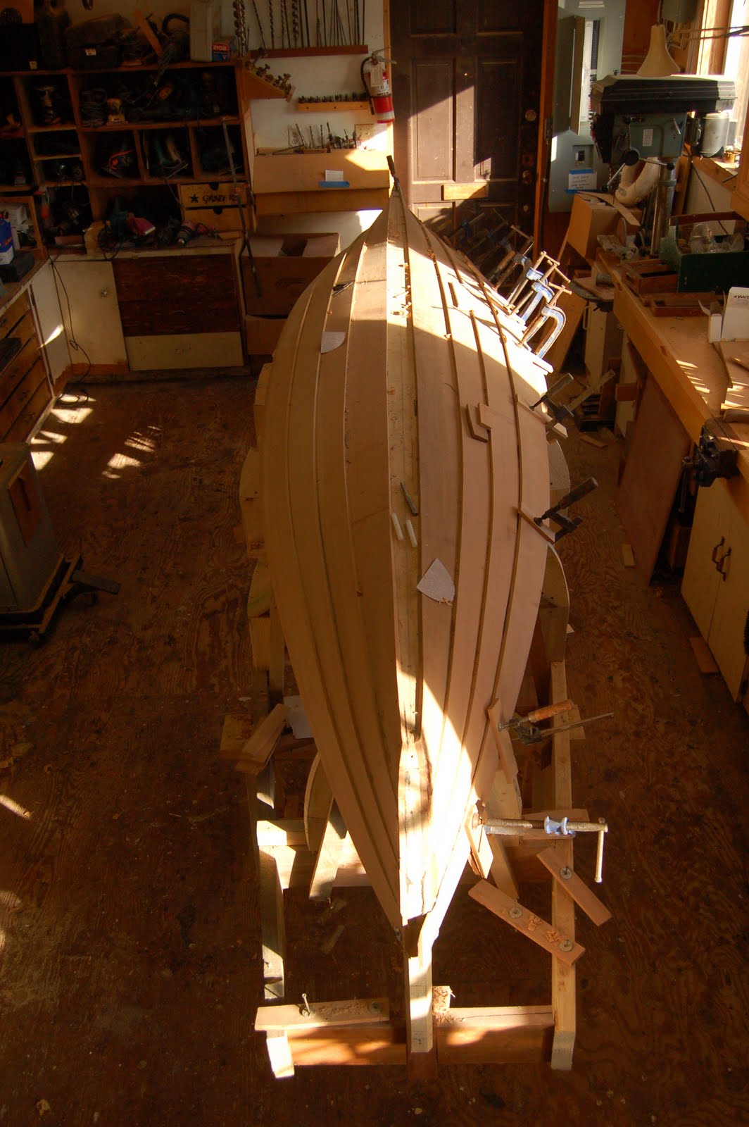

    Here is the boat fully planked and in the next couple of days we will be pulling her off the molds. We enjoy building lapstrake boats. It's the fastest of all planking. Including the scarfing each plank we average a set of planks every 5 hours. So far we are 40 hours into the boat.
    We are hoping to have the boat done at about 100-120 hours. Lets see how we do!
