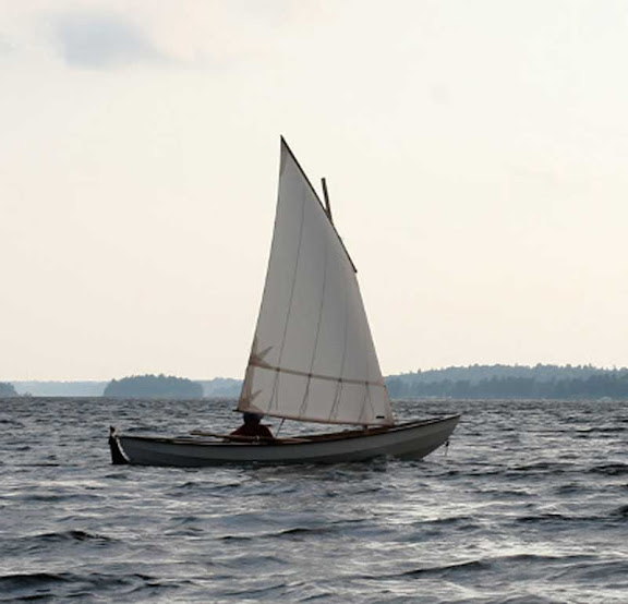

    Jan 2008
    Wow-Ming
    7,255
    Default Re: Gypsy versus Skerry?
    Guess you can't link to CLC photos.
    In any event, here's a much better-looking sail for the CLC Skerry, a balanced lug sewn by Todd Bradshaw.
    The taller peak must allow sailing closer to the wind. I like the hull, although with my long legs I don't fit inside it.
