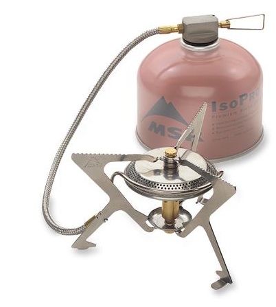

    No kerosene in the M1950. But MSR (Mountain Safety Research) makes several excellent stoves using the same burner design that burn a variety of fuels. These are popular with climbers because they also melt snow well but are lighter than the M1950. But bring money.
    http://www.rei.com/product/709002

    Quote Originally Posted by Bob Smalser View Post
    I've been using my MSR for almost 20 years. It has never failed me once in the field.
