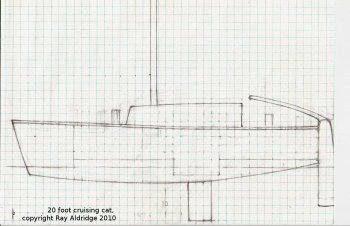

    By the way, a rough sketch of the new boat:
