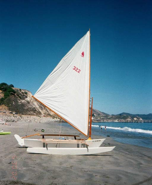

    How about a Malibu Outrigger?
    A short history of the Malibu Outrigger by Dana Sandiego
    (↑ click-able link to the article ↑)

    Outrigger canoes are a traditional choice for both fishing and surf landings in about 1/2 of the world. Check out Gary Dierking's designs for some inspiration.
    Dan
