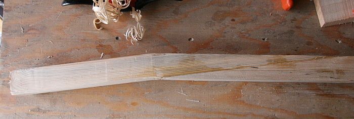

    Oh, here is how I solved the rake of the mast problem. It requires only one cut. So far it has held up fine. Spruce glues very well. I still need to do some tinkering with the sail balance for at times it has too much weather helm. Without this mast modification the weather helm would be wicked indeed.
