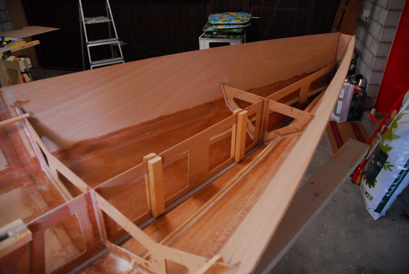

    Here's a nice view looking along the stb stringer as it passes throuhg bulkhead 2.
    Another photo of the "steaming"
    And the fit of the stringers against the stem
    The dagger board box bottom bevel
    And here is our "clamping" of the stringer into the transom. We included small gussets of larch to increase the gluing area to prevent the stringer cracking out of the bulkheads while moving the thing around before the planks were glued and filleted.

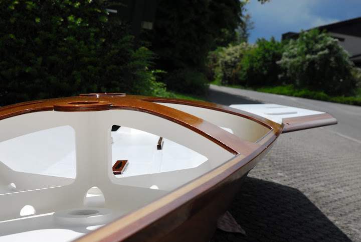

    Default Re: What it's all about
    Time for an update:
    We now have the Hull almost complete - only need to add a beam near the bow, and paint.
    Here are a series of photos:
    Here we now have the wing leading edge laminated, faired to the appropriate curve, and glued into position. You can also see that the decks are also laid.
    Turning her over here the wing bottom skin is glued and filleted to the hull. I'm about to trim the wing leading edge with the Skilly:
    Here are a couple of the inner layer of the gunwale, larch, being laminated on, and the X-frame which forms the bracing to take the mast partners is also in place and filleted.
    Finally recieved the sail... was rather expensive, and no fancy material either! 114 sq ft

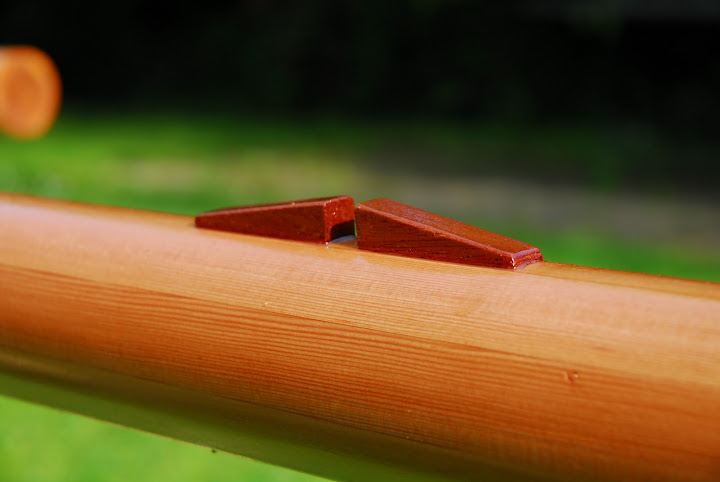

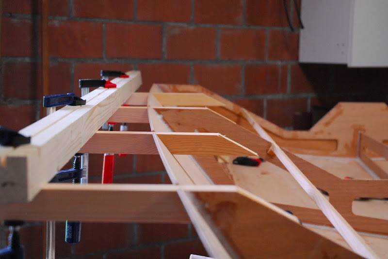

    Here, what appear to be floor joists for some outrageous deck house are some clamps I made up to clamp the Sipo wing edge capping.
    Others have tried this with complicated systems of ropes and straps. Clamps seemed easier to me and they only cost 20 CHF to make.
    Here the top of the X-frame/deck/mast partners is being let into the gunwale top edge. You can also see the Sipo we laminated outside the Larch gunwale.
    and here the Sipo wing edge and leading edge faired into each other. The timber behind the leading edge is cedar.

    From this angle one can see how wide and flat this boat will be.

    Progress. Got the first coats of paint and varnish on this weekend.
    Not yet complete but makes a huge difference.
    The varnish is International "Compass" which is as far as i know replacing the goldspar. It dries fast - 40min - but it doesn't go over epoxy worth squat. Covers ok on the 207 clear finish epoxy, but a few places where we had normal slow cure 206 hardener, it's awful.
    Also got some varnish on the spars. they're not finished yet, but good to get some protection coats on.

    Small amount of work done this weekend. Deck beam on foredeck added as spinnaker take-down guide. Scary work checking it into the gunwale, one false slip with saw or chisel and disaster for the polished wood. Luckily averted.
    Test bend of laminae. Gaps noticed and extra planing effected. Final beam only three layers.
    Carefully Carefully...
    After some gentle chiseling with razor sharp chisels
    And all neatly fitted with a gusset to stop the spinnaker jamming in that corner upon takedown.
