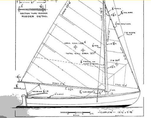

    Or, if you want an older Northwest design, you might take a look at this:
    There's a 15' 6" boat in there that might interest you, called Curlew.
    I'd want a higher boom, though.
