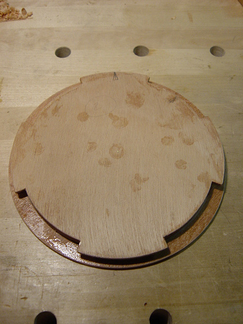

    I eventually decided to go with a hatch design that uses a bayonet mount, similar to what one sees in lens mounts on many SLR cameras.
    Here is the bulkhead seen from the cockpit side of the bulkhead:
    Seen from (which will eventually be) the inside:
    The hatch cover seen from the outside:
    Seen from the inside:
    A pic showing some detail of the the 4 plywood layers:

    Default Re: Wee Rob - Bulkhead Hatches
    How it all fits together:
    Some details:
    • 4mm plywood
    • Cut out using a simple circle jig and a Bosch palm router with a 2mm bit.
    • The hatch cover consists of 4 layers:
      • 1x Outer cover OD 220mm
      • 2x Spacer discs OD 190mm
      • 1x Lock disc OD1 210mm, OD2 190mm
    • The hole also consists of 4 layers:
      • 1x Bulkhead hole ID 220mm
      • 2x Spacer rings ID 220mm, OD 250mm
      • 1x Lock ring ID1 190mm, ID2 210mm, OD 250mm
    • Seal to be provided by 15mm wide 4mm thick adhesive neoprene seal (comes in a roll) attached to the underside of the cover.

    Songololo, is there any "ramp" on the tabs for the actual bulkhead cover in the bottom photo to compress the foam as it truns or are you simply pushing the cover in to compress the foam and then turning?

    Canoez - nope, no ramps! I decided to keep the engineering simple and rely on compression to provide the seal. The neoprene seal is the same thickness as the ply i.e. 4mm. On the prototype, compressing the neoprene seal by more than about 1mm resulted in the cover being very difficult to turn. I plan on the 2 coats of epoxy and a few coats of paint to provide the thickness for compression.
    James - agreed, the plywood looks better than the 'plastic' options; also provides a flush surface with no protruberances. Plan B is an 8'' Beckson deck plate, which requires a cut hole of 216mm diameter. The bulkhead hole is currently 220mm and so should theoretically be easy to install if plan A doesn't work out
    The access hole (i.e. taking the locking tabs into account) has a diameter of 190mm, which is larger than that stipulated on the plans. The larger size will allow a small dry bag to pass through without snagging.
