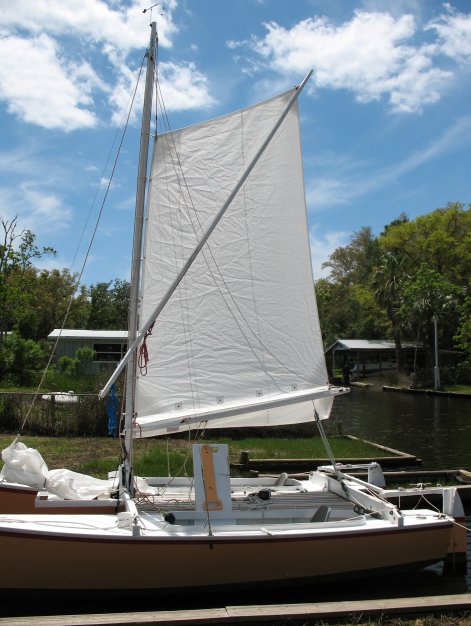

    Sprits are harder to reef than lugs. With sprit rigged boats I have two rigs rather than reef a lot. With booms I find that if you cut them low foward and up at the clew, the boom will generally clear you taking and jibing and you will lose very little in performance. A double ended boat is really hard to get the sail to set right without a boom.
    The most efficient of these rigs that I have used is a full batten standing lug with the lower batten acting as a boom and the foot cut so that the sail is pretty much self vanging. The mast for a lug rigged boat should be quite stiff so that it does not bend when you flatten the sail by pulling down the down haul. It has a very high aspect ration with almos a vertical leach so in this boat there is no problem with sheeting angles. The foot is much shorter than the boat.

    What James says about the difficulty of reefing spritsails is a generally accepted view, but I haven't found it so, personally. The main problem is that the sprit has to move down the mast as the sail is reefed, and at some point, it can go no lower. So you won't have as many potential reefs as you might like. I have only one generous reef on Slider's sprit main.
    But on the other hand, spritsails can also be reefed by a process known as scandalizing-- the sprit is simply removed, which cuts sail area by almost half, in my case. So, up to 25 knots or so, I reef in the conventional way, but if it blows harder, I can scandalize. I've been out in 30 knots with only a scandalized main, and the boat still went well to windward, to my astonishment, despite the sloppy appearance of a scandalized main.
    My choice was driven by the fact the Slider is a cat, and an unstayed mast is difficult and heavy to engineer out on the crossbeam of an open deck catamaran. (Gaff has more weight aloft, not good for fine hulls with a tendency to pitch.) But the biggest pleasant surprise is that the sprit-sloop rig has proven to be quite weatherly. It's really nice to be able to eat up big chunks to windward, especially since Slider has no engine.
    There are other possibilities for reefing a sprit sail. The Thames barges reefed their vast sails in sections, by brailing. But in general, sprit is a rig I would consider only for a fairly small boat.
