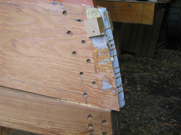

    Once the planks were cut, primed, and beveled, they were installed. It seemed easire to start at the draketail stern, register the plank on the transition board to the vertical staving and them clamp and screw the plank off moving forward. I did the planks in pairs to even out the strains on the strongback. Clamp and screw three frames on one side and then do the other side... The planks ran long at the stem to be trimmed flush and fitted with a false stem.
    There were some gyrations trying to pull the planks together at the stem. There was no easy way to get the clamps to stay put. Then I remembered a trick from Mr. Bass, my 7th grade shop teacher. He had taught me how to glue up a block to turn a casting pattern using newspaper at the centerline. Turn the blank, and the a quick nudge with a chisel separated the the pattern into two halfs. Seemed like I could use the same approach to glue clamping blocks to the planks at the bow. I got the appropriate angle for the blocks from the lofting and went to work.
    Then a quick stroke with a slick would remove the block. I actually removed the blocks in pieces, removing one clamp and sawing through the block so a small piece could be removed. The screws were then installed where the clamp had been. Repeat as necessary untill all screws are in place. The rest of the newspaper will disappear during the sanding and fairing process.
    And the results with all the planks in place...

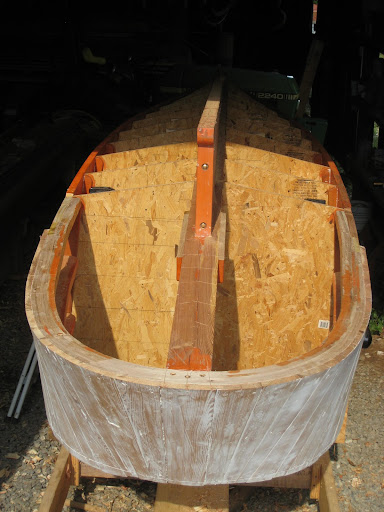

    Once the side planks were in place, it was time to bevel the chine logs and planks to receive the cross planked bottom. The chine had previously been pretty well beveled. This operation refined the bevels and matched the planks to the chine log. The initial beveling was done with a slick to get close, then followed up with a block plane and a try stick at the stations. Once the stations were at the right bevel, the job was finished between stations with a larger hand plane. The stick was moved between stations to check progress. Lumber crayon was used to mark high spots as needed.
    The process seemed to work fairly well....

    I've now finished planking the stern 5 feet of the bottom. The process was a bit of a wrangle as I wanted to leave the planks proud by about 1/2" to protect the fragile end grain of the vertical stern staving. The 1/2" was then diminished to fair with the sides as the hull approached full beam.
    The process was something like: Install plank with some overhang, trace stern with 1/2" offset, remove plank, bandsaw to shape, reinstall shaped plank, fit next plank, continue until all planks were fit. Then fair the curve of all the planks, tapering the overhang to zero at full (almost) beam. Remove all planks and use round over bit in the router to shape both the top and bottom edge. Renistall all planks for the last time....
    So, pictures to follow:
    All planks fit, shaped, and ready for installation:
    The bed for the first plank, coated with Dolfinite and with the string in place to seal against the side planking:
    The first plank, which sets the angle of the restof the planking. The kerf is to allow the plank to bend slightly. The kerf was primed with red led and packed with linseed oil soaked string before installation. The string compressed enough to allow the bend.
    And the result, the planked bottom from the outside:
    And from the inside:

    OK, so having gotten past the fiddly stern bottom planking, things are speeding up a bit.
    Everything I have read says to clamp the planks tightly and/or drive in a tapered plank at intervals of about 3 or 4 feet. I didn't have a way to conveniently clamp the initial part of the stern planking. So, as soon as I got alongside the keel, I put in a set of tapered planks to a) wedge the stern planks tighter and b) leave an opening to clamp the planks as i move forward.
    Here's the two tapered planks and the opening left for clamping.
    The taper was a little less than 1 degree (about 3/8" in 24"). Easy enough to cut with a tapering jig on the table saw. Two planks on each side were cut with the same, but opposing tapers. That way, the angle of the planks to the keel remains the same, but the driving the tapered plank in will tighten things up.
    Here's the taper jig. This shot was staged after the fact with the saw turned off.
    And here's the plank put in by hand as far as it wants to go. If it won't drive home later, light passes on the jointer should allow for fine adjustment of the fit.
    A shot of installing additional bottom planks. I also made up a little shelf to slide along the keel to hold tools. I could set them on the planks at the relatively flat stern but that will be harder as the deadrise increases... And, now I don't have to carry tools from side to side as I plank.
    Each of the planks is left a bit long and then trimmed with a Japenese pull saw. There is enough flexibility in the saw that I can pretty well trim the planks to the final, fair, length. The saw is flattened against the side planking, which sets the bevel and curve nicely. Just don't get in a hurry.
    And, finally, some new bottom planks at the end of installation.

    Some more progress was made over the holidays. Basically on two fronts: 1) bottom planking and 2) making the false stem.
    Some further details on the bottom planking:
    About every three feet I taper two planks and leave a gap. That way I have some place to clamp the planks tight before screwing them down.
    Both ends of the planks get bedded in Dolphinite spread with a notched putty knife. I filed the notches with a triangular file. All the contact surfaces, including the underside of the planks, are first primed with 3 coats of red lead.
    Setting the next tapered planks. I draw the inner plank back from the keel a bit and then screw down the outside tapered plank. When the next run of bottom planking is complete and the next pair of tapered planks and the next gap for clamping are ready, the previous tapered plank is driven home and screwed in place. So far, (4 tapered planks) no problems with getting the planks to go home and snug up.
    The next gap ready to continue on...
    And, enough bottom planking that it's starting to look like a boat...

    First a discussion of beveling the side planks. The first step was to transfer the line of the outside surface of the bottom plank to the outside of the side plank. This was done using short sections of bottom plank that would rest on the keel rabbet and the chine log, and a purpose made marking gage.
    Pencil marks were made at short intervals and then connected with a batten. I then kerfed down to the pencil line with a pull saw.
    Then I started the process of trimming the side planks using the same trusty Swedish carpenter's ax.
    The ax was followed up with a slick to get closer to the line.
    Which was followed with a block plane.
    The plank was brought to the line, but with no bevel. The trimmed top edge of the plank was kept horizontal and then rubbed with carpenter's crayon to highlight the edge.

    After coloring the top edge of the side plank, I began creating the interior bevel using a slick. The idea was to leave just the finest line of colored wood at the outside of the plank and connect that line with the outside edge of the chine log.
    Starting the process
    And the finished bevel.
    Now the process of shaping the lumpy, rough shaped bow chunks and finishing the keel rabbet to 1) look like a bow and 2) accept bottom planks.
    The lumpy port bow chunk also showing the unfinished section of keel rabbet.
    Final (almost) shaping the bow chunk started by connecting the keel with the outside of the side planks with a series of pull saw kerfs.
    The excess wood was then removed with the trusty ax and then a scrub plane until the kerfs just disappeared. Then the end of the chunk and the keel rabbet had to be finished to accept planks.
    The end of the chunk was cleaned up with some chisel work and the keel was kerfed to depth with a 4 1/2" Dewalt battery saw.
